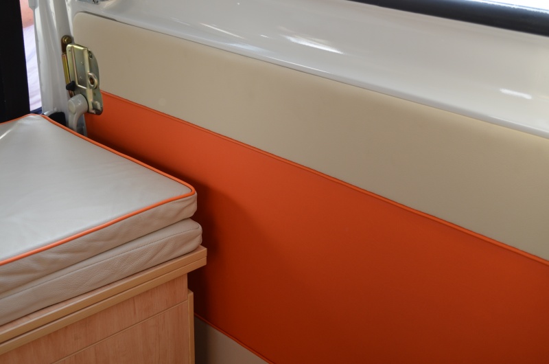

Finally fitted ours , very pleased
Posts : 2895
PostSubject: Re: New Door Cards & Eyelids   Tue Apr 30, 2013 7:07 pm
Very nice. Love the colour Smile
Posts : 1814
PostSubject: Re: New Door Cards & Eyelids   Tue Apr 30, 2013 7:08 pm
And Amazed , i finally worked out how to upload photos ![/url[url=http://www.servimg.com/image_preview.php?i=14&u=17540547]
Posts : 1814
PostSubject: Re: New Door Cards & Eyelids   Tue Apr 30, 2013 7:09 pm
We share similar tastes! Very Happy
