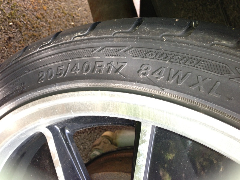

I've just been out to look at ours which came with the van from Danbury.
It looks like they're: 205/40R17 84WXL

It looks as though you have a smaller overall wheel diameter than skytiger, Martin.
Although you have 17" wheels (431.8mm) as your tyres are low profile, (40% of 205mm = 82mm then double it (164mm) and add together to get overall diameter of 595.8mm.
Your load rating is 500kg per wheel (84) and speed rating is 168mph (W) which is reassuring. Very Happy
The XL means extra load, which doesn't mean you can carry more kit, it just means the ply construction is reinforced because they are low profile tyres.
I may be talking rubbish, but that's my understanding of it. Smile
