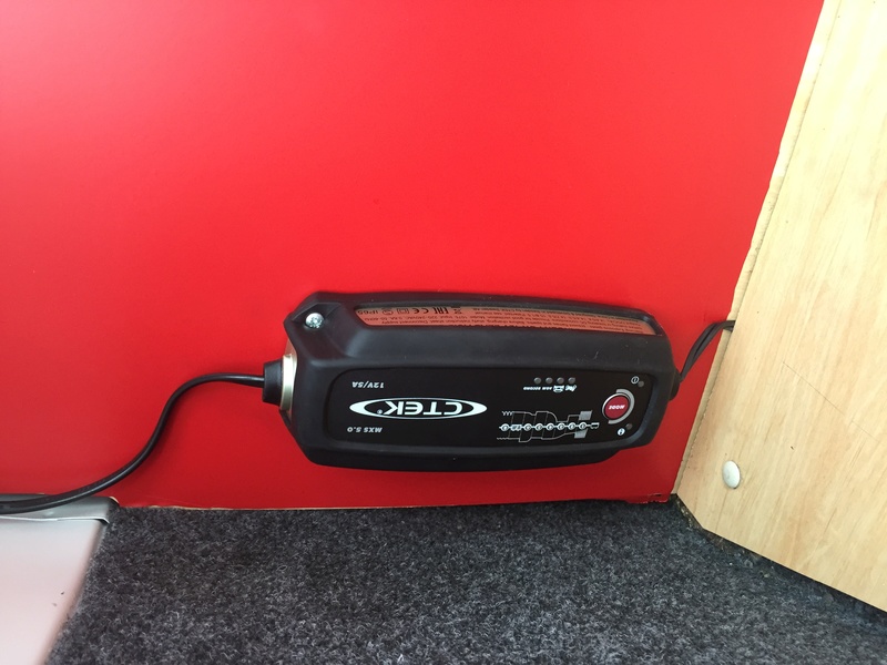

| Eddie's been at Brand Autos for a couple of days having a pre Kaper tune up. Whilst there I asked Paul to install the CTEK charger unit. It is now permanently wired to the leisure battery and connected to a mains socket inside the van. The control unit is attached to the back of the wardrobe. You'll notice in the second picture that there is an orange connection which means that an extension wire can be attached to charge the starter battery. | |
| Subject: Re: CTEK Battery Charger Install Wed Jul 13, 2016 9:22 pm | |
| Looks good. Would it have been possible to wire it straight to the EHU point, freeing up a mains socket? ________________________________________________________________________________ Absinthe makes the heart grow fonder
Cabin : Exec 027 Location : Fair Oak, Hampshire Posts : 2849 Join date : 2012-04-19
| Subject: Re: CTEK Battery Charger Install Wed Jul 13, 2016 9:57 pm | |
| This wouldn't have been easy as my EHU is situated underneath the van. I was advised that this was a good place to put it although in hindsight I would have preferred it in the engine bay like everyone else. | |
