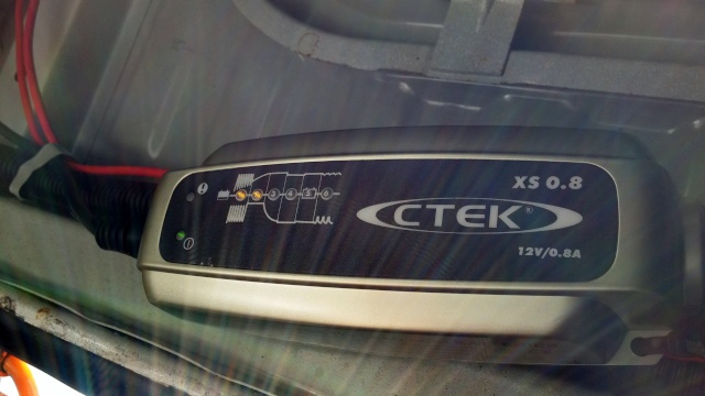

| Read a post about one of THESE a few weeks ago and thought I'd get one to install into Ginger to keep her battery topped up over the winter months. The unit will condition and charge the battery. It's also IP65 rated so it doesn't matter if it gets a bit wet and dirty. The unit come with leads that can be permanently connected to the battery. ![battery - CTEK Battery Charger Install 20150510](https://i.servimg.com/u/f19/15/29/64/72/20150510.jpg) Once the lead was connected I fitted secured the charger inside the engine bay. ![battery - CTEK Battery Charger Install 20150511](https://i.servimg.com/u/f19/15/29/64/72/20150511.jpg) And wired the other end into my Hookup socket ![battery - CTEK Battery Charger Install 20150512](https://i.servimg.com/u/f19/15/29/64/72/20150512.jpg) Once that was done, I connected the battery lead to the charger, plugged in the Hookup lead and Hey Presto the battery is now being charged ![battery - CTEK Battery Charger Install 20150515](https://i.servimg.com/u/f19/15/29/64/72/20150515.jpg) ![battery - CTEK Battery Charger Install 20150516](https://i.servimg.com/u/f19/15/29/64/72/20150516.jpg) The advantage of plugging it into the hookup lead also means it's connected to my Hookup Buzzer so I don't accidentally drive off with the lead plugged in. Another possible advantage is, I think by looking at my intelligent split charger relay, when the starter battery is charged the relay will then switch over and charge the leisure battery, not 100% on this though ________________________________________________________________________________ ![battery - CTEK Battery Charger Install Img_4810](https://i.servimg.com/u/f29/15/29/64/72/img_4810.jpg) Ginger man without a ginger van ![sunny](https://2img.net/i/fa/i/smiles/icon_sunny.png) | |

| Hi KM what protection do you have for the charger how do you turn it off, the smart com if you take the cover off there is a pot you can change the threshold voltage you may find if charger output approx 13.6 it may activate smartcom all the time. Tim | |

| It's a smart charger so once the battery is charged it will swap to trickle mode. Not sure what the output is but think the charging voltage is around 12v. Will put the meter on it when I get home and see what it says ________________________________________________________________________________ ![battery - CTEK Battery Charger Install Img_4810](https://i.servimg.com/u/f29/15/29/64/72/img_4810.jpg) Ginger man without a ginger van ![sunny](https://2img.net/i/fa/i/smiles/icon_sunny.png) | |

| If it's like mine (I have a Ctech MXS 5.0) then the output will change based on the charging stage - recondition, absorption, float etc. ________________________________________________________________________________ www.alpinegrovetouringpark.com Twitter: @AlpineGrove Facebook: facebook.com/alpinegrovetouringpark

| - Dennis wrote:
- Hi KM what protection do you have for the charger how do you turn it off, the smart com if you take the cover off there is a pot you can change the threshold voltage you may find if charger output approx 13.6 it may activate smartcom all the time. Tim
Just checked both batteries and they are both reading 13v. Should have measured them before installing the charger but looks like they've both got a charge. ________________________________________________________________________________ ![battery - CTEK Battery Charger Install Img_4810](https://i.servimg.com/u/f29/15/29/64/72/img_4810.jpg) Ginger man without a ginger van ![sunny](https://2img.net/i/fa/i/smiles/icon_sunny.png) | |

| Working well what I meant with protection did you connect it direct to back of blue plug or did you put it through a low rating mcb if not you are relying on the protection of the hookup box wherever. Tim | |

| It's wired direct into the blue hookup plug so relying on the hookup box when out and about. To be honest I very rarely use hookup when camping, it's more for when she's parked up at home and not being used. ________________________________________________________________________________ ![battery - CTEK Battery Charger Install Img_4810](https://i.servimg.com/u/f29/15/29/64/72/img_4810.jpg) Ginger man without a ginger van ![sunny](https://2img.net/i/fa/i/smiles/icon_sunny.png) | |
